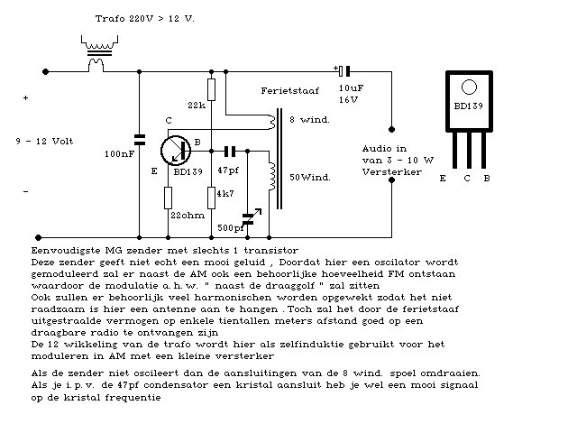

http://www.radiosparks.com/images_d/Mgtx3.gif

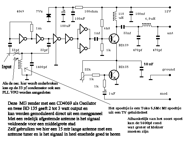

http://www.radiosparks.com/images_d/Mgtx4.gif
